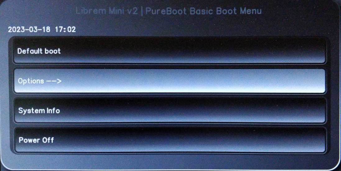

  6. Turn on the server while pressing the ESC key on the keyboard repeatedly until you see the PureBoot Basic Boot Menu screen. Select “Options –>”.
    step 1

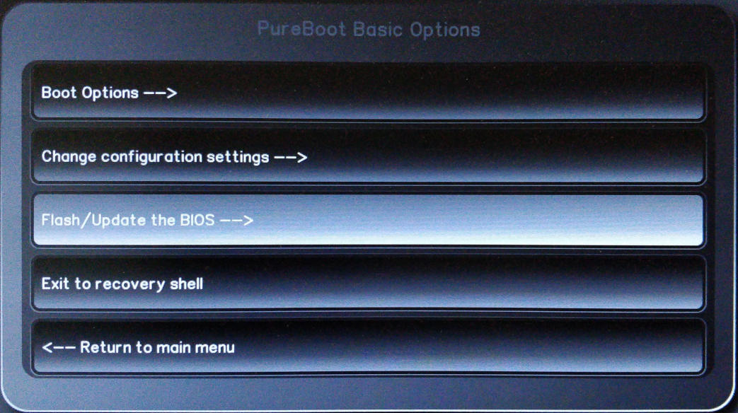

  7. Select “Flash/Update the BIOS”.
    step 2

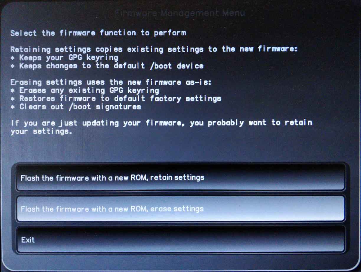

  8. Select “Flash the firmware with a new ROM, erase settings”.
    step 3

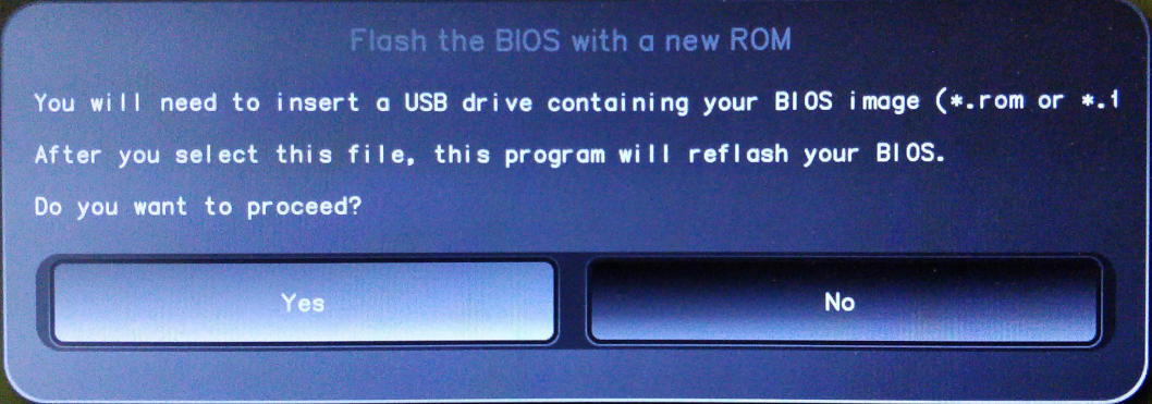

  9. The system will ask if you want to proceed flashing the BIOS with a new ROM, select “Yes”.
    step 4

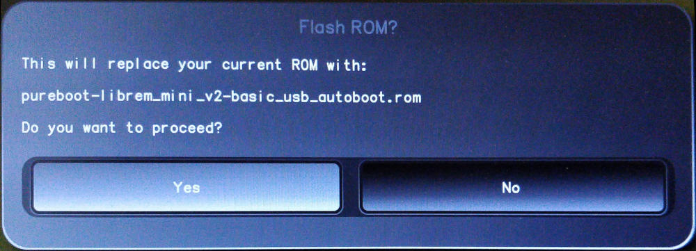

  11. Confirm you want to proceed with the flash by selecting “Yes”.
    step 6
